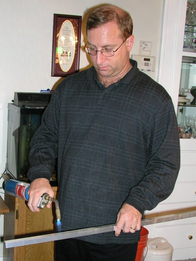

Postby mikeschn » Sat Feb 25, 2006 6:14 pm
:sweaty:
Posts: 19185
Images: 479
Postby PaulC » Sat Feb 25, 2006 6:40 pm
WOW a photo of Mike without wine! :lol:
Cheers
Paul
PS Love the safety equipment being used :lol:
PaulC
3rd Teardrop Club
Posts: 4410
Images: 36
Location: Laura, Souther Flinders Ranges, South Australia
Postby TomS » Sat Feb 25, 2006 6:46 pm
What you're looking for is an orange glow itn the flame as shown here.
BTW -- Mike, don't you get burnt holding aluminum in your bare hands while anealing? That aluminum get HOT!

Postby mikeschn » Sat Feb 25, 2006 7:34 pm
Yea, no safety equipment in that photo... I was just doing a show and tell with out really warming up the aluminum. I probably should include a Norm Abrams disclaimer...
Don't try this at home, and always be sure to use your safety equipment! :tipsy:
Mike... :lol:
