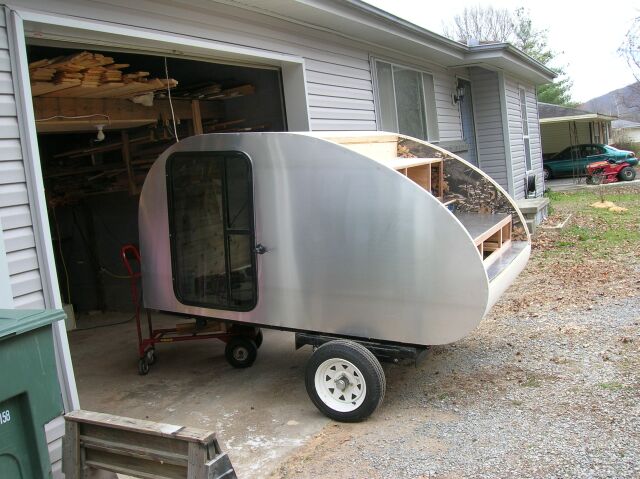

Jack, I tried my hand at annealing some aluminum angle today. It is .063 3/4 X 3/4 inch and I must have done something wrong. I took a sample piece and heated it until it disintegrated just to see how much heat it would take to over heat. I was surprized that it took quite a while for it to be wasted. I tried sooting a piece and heated it until the soot was gone and then tried to make a bend. I went very slow and used a rubber mallet and it did not go well at all. You posted that you used a form so I gave that a try and made one out of 3/4 inch plywood. I heated the aluminum longer than it took for the soot to disappear with no bad results but that was one tough bend and I still had ripples in the side leg. I worked with it for a good while and got it looking ok but not OK. It was a tight radius, I will have to admit. Do you have any suggestions as to what I am doing wrong?

Jim, if the soot disappeared...it is annealed. That 3/4" leg is gonna be hard to bend ripple free for an inside bend...none of our stuff had a leg longer than 5/16 over all...what are you using it on...con you reduce the area in the radius (make it a thinner leg at that point)....we used both 1" & 3/4" angle and channel and cut the legs down so the where no longer than 5/16 overall...this was bent tighter than 6 "s with the addittion of some kerfs...on our front box doors which have a 2" radius we removed material in the radius ruducing the leg to about 1.8"....this worked to fit that 2" radius...no pics right now but maybe tomorrow

Jack, I should have read a little closer. I am using the full 3/4 inch leg and can see where it would work like a charm with a shorter leg. If I had done my homework and found out that there should only be a 5/16-1/4 inch leg, I wouldn't have stapled the aluminum so far from the edge. I have no choice now but to go with the 3/4 inch leg now so I will just do the best I can. The bend I was working on is on the very bottom rear

Jim, remember that as you whack and woll that trim that it will become work hardened...it can be re-annealed if need be and any use of a hammer should also use a couple of hardwood dollies, even if using a rubber/plastic/wood mallet....on thing we found on making tight radi was to use a 6" long dolly to bend with...use the dolly with 2 people...one pulling on the dolly to keep pressure and start bend...the other with a mallet, taping on the dolly as it rolls around the curve so that you get a pull anna tap on the same point at the same time

Jack, I didn't know you could reanneal it, that will be a super help right there. I think I have a way to make it work and if it does I will post some pictures and maybe it will help someone else. I can see real quick why you would want to keep pressure from the end. Thanks again Jack.
