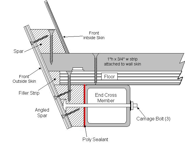

For attaching the sides to the floor, I have two attach points. One is the 1" x 3/4" strip that runs down the length of the side, 2" from the bottom. It will sit on the edge of the floor, with the side skins going down along side the side rail of the frame. That strip will be glued and screwed to the floor, which is bolted to the frame. Here is that diagram, looking from the front end of the trailer. There has been one difference since making this diagram. I will use poly sealant between the side skin and the frame, not construction adhesive.
The 2nd set of attach points are at each end of each side. I've bolted a spar to the front and back end rails with 3 carriage bolts for each spar, with polysealant between the spar and the end rail. Then, the floor end is scred into the spar. Next, I will add another spar on top of the floor, screwing and glueing it to the floor. A filler strip will be put in at the end of the floor to smooth things out. This next diagram shows how that looks (or will look). The front and read bottom corners of the side skin will be screwed into both of these spars, two 3" screws into the end of the bottom spar, and one into the top spar. All of this should tie the sides securely to the frame. This diagram is looking at the front left corner of the side
Where I am sonsidering the Gorilla glue is to glue the strip to the floor, and the side skins to the ends of those two spars front and back.

The first thing that I noticed is that you are not connecting the plywood sides directly to the frame. You might consider drilling through both the side and the frame and putting a couple of carriage bolts through them. You might wait until the aluminum is on (if that's the case). I figured there would be a lot of force pushing down on the sides when the trailer tires hit a speed bump, pot hole, or just bounce down the road. A direct connection (besides the poly adhesive) might give a little assurance. I actually have little tabs welded under the side rails that the plywood sits on to give better support.

I hope you left more clearence than what you've shown on the skin and the frame rail...
I was told to leave at least 1/4" and I figured otherwise... I figured I could easily get by with an 1/8".
What I did was just get too damn cute on paper.
I will be able to make spacing changes and make what I have work, but I'm planning on building a new frame instead. (Dropping about 100 lbs. of steel while I'm at it) :R

I thought you'd want the side skin and sealant pretty close to prevent water from getting in. The sealant should press out the bottom, filling the gap well. So, why a quarter inch clearance between the plywood and the frame? I'm putting in poly sealant between the two, and that will probably compress to about 1/8". I plan on tightly clamping the plywood to the rail, then loosening the clamps while I put in the screws through the strip into the floor, to pull the floor and strip tightly together. Then, when the floor and side strip are secure, re-tightening the clamps on the side skin bottom and side rails.

Fornesto, I think your idea of bolting is a good one. I can cut a couple of pieces of 2" x 2" angle iron about 3-4" long, and bolt one to each end of each side. I can use a forner bit to counter sink through the skin and just put a carriage bolt through the framing into the angle. Then, bolt it through the side rail. Then, I can fill in the hole in the skin with bondo. Another design change has been made.
