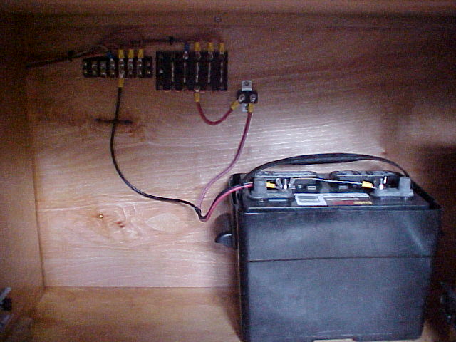

I ordered mine from WAYTEK WIRE, here's a pic:
I didn't install the 30amp fuse between the battery and the block, do I need to do that? I thought the fuse block would take care of those type issues. :thinking:

Postby SteveH » Thu Mar 30, 2006 5:12 pm
I used an AutoZone 40 amp braker instead of a fuse. Works the same way, just will trip and not have to be replaced.

Postby Chuck Craven » Thu Mar 30, 2006 7:34 pm
Earl You need it!!!! :thumbsup: Fuse blocks are notorious for shorting out or something falling on them and making a short. It’s like the main breaker in your houses electrical box! It’s the last chance before fire in the hole.
Most of that type of breaker will reset it’s self when the short goes a way. But some have a button you push. Ether way install one. A master cutoff switch is also a good idea when traveling so some thing doesn’t turn on and drain the battery. If you are charging the battery from the car it’s a must to disconnect the any possible load so the battery will charge.

Postby Arne » Thu Mar 30, 2006 7:47 pm
Yes, it is a good idea to have a main fuse (or breaker) as close to the battery as you can. Usually, that would be a 30 amp.... and the fuses in the block would be smaller.
It is probably not quite as important in a tear (though a fire could be deadly), but on a car surrounded by metal, it is critical, as wire insulation could fail and cause a short quite easily.
Btw. nice pictures above, make it very clear how to set it up... also look in this thread, about half way down, shows Mike's set up with closeup pics.
