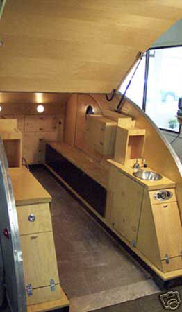

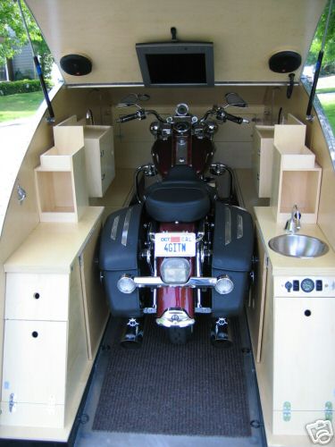

Here are a few pics I snagged of E-Bay when this fella was selling his trailer. It was really set up nicely.

Woah.... what a nice design. Just using it as a regular tear, that opens it right up, so when you're camping it becomes a walk in....

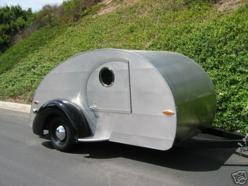

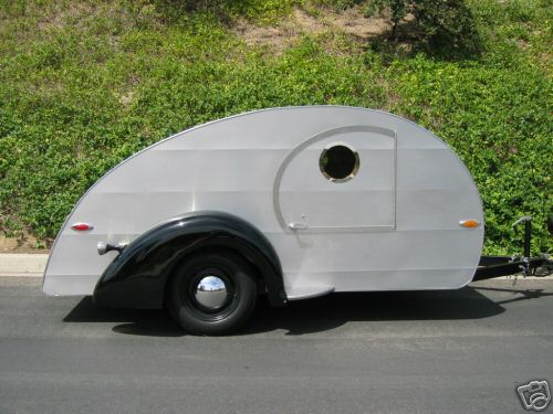

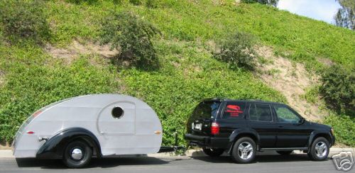

Here are some pics of the outside. It almost looks like it is fabric covered on the sides. Does anyone remember the details of this trailer. It was really nicely finished.

s4son wrote:Here are some pics of the outside. It almost looks like it is fabric covered on the sides. Does anyone remember the details of this trailer. It was really nicely finished.
The sides are creased alum. and the tear also has air bags so it can be lowered and rased as needed.
