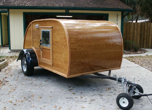

I would love to trim the edges of my TD with a wood trim but would need a corner molding that could be bent to the radius.
Anyone know of anything??? How have others trimed thiers?
Ira wrote:My rope bent real easy...
ezbie wrote:I would love to trim the edges of my TD with a wood trim but would need a corner molding that could be bent to the radius.
IndyTom wrote:Rainjer,
That is one of the ways I have been concidering doing it. Biggest problem for me with steaming is that I am building a much larger than normal teardrop for a family of four. If I use continuous pieces, I will have some very long pieces of trim to steam. Guess I will just have to use a longer chamber and a bigger steam generator.
Steve_Cox wrote:Are you thinking something like this?
