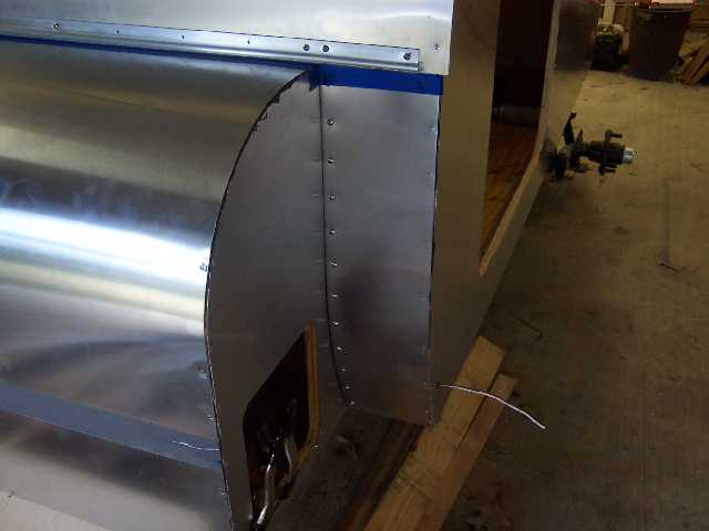

...the only other source I could give ya for the wide AL is Lufkin Trailers in Shreveport La....you might wanna talk to Lenny(aka Mcteardrops) whom you met at Beaver's Bend, he got his Al from them...I wouldn't worry to much about a seam...all 5" CampInns are seamed across the top and on our Alligator Tear we had a seam where the skin from the front box and the side panel met the skin covering the rest of the tear...we overlapped 1 inch, laid a heavy bead of automotive urethane windshield adhesive/sealant(as does Camp Inn on their seams) and put a screw every couple of inches...in the pic below, the seam is hidden by the awning rail but the rail has nothing to do with actually sealing the seam...
