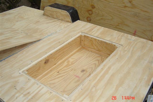

Postby Kens » Sun Apr 16, 2006 6:52 pm
Image This is built on a TSC trailer the storage is about 38"x 20"something x 8" deep. Big enough for two fold up nylon chairs I'm glad I built it (not used yet )[/img]

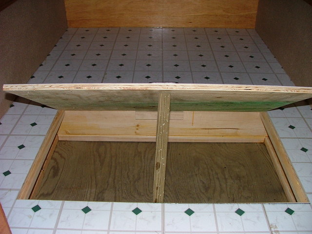

Postby Joanne » Sun Apr 16, 2006 11:08 pm
You mean like this?
Here they are completed.
I don't think I would make the large one quite so deep next time, but I really like to have the additional storage.
There are a lot more pictures on my website.

Postby surveytech » Mon Apr 17, 2006 10:01 am
Kens wrote: This is built on a TSC trailer the storage is about 38"x 20"something x 8" deep. Big enough for two fold up nylon chairs I'm glad I built it (not used yet )
Kens,
what kind of clearance do you have under the storage box?
Just curious as I have a TSC trailer also.
Thanks,
Walter
surveytech
Posts: 776
Images: 6
Joined: Fri Apr 29, 2005 7:13 pm
Location: kissimmee, florida
Postby Kens » Mon Apr 17, 2006 12:34 pm
Walter I built a 2"x2" framework over the metal frame that raised it up a little.Look at the picture above I went half way into the fenders. Trailer is all covered with tarps or I would run out and measure. I can tell you this it is about equal with the axel. Don't go below. Kens
