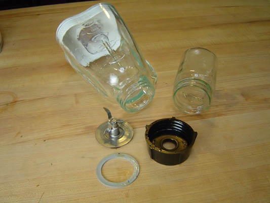

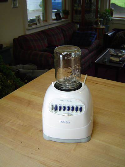

I noticed that Mason jars have the same thread on them as the bottom of the blender.
So there is nothing stopping me from screwing the blender gasket, blade and base into a Mason jar and making my own "Magic Bullet"
Just unscrew when done and drink like a hillbilly.
Don't try this for Margaritas! One of the ice cubes flew at high-speed and put a crack in the glass!

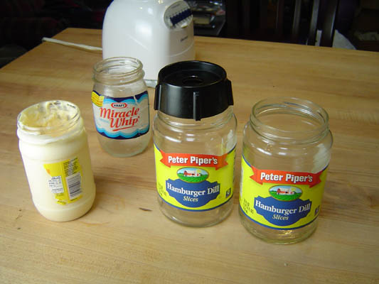

So I started experimenting with other Jars.
Pickles jars are too big, peanut butter was not quite right. Mayo jar worked perfectly. The threads on the plastic mayo jar was just a little different, I think it would work fine with 2 gaskets instead of one.

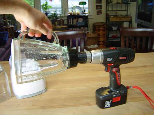

The Oster brand blender has a nice solid METAL drive shaft with a square cross-section. The hole in the blade base is 8-sided, to make it easier to line up. If you put an adapter into a cordless drill that goes from the standard 6-sided shape that gets chucked in a drill, to a 1/4th inch square, like for driving a 1/4inch socket, it fit perfectly into the base of the blender. The little tiny ball-bearing on the 1/4in socket adapter even holds it in real nice.
I thought this would be great for fancy girly drinks while out camping. A cordless drill is basically just a battery-powered electric motor!

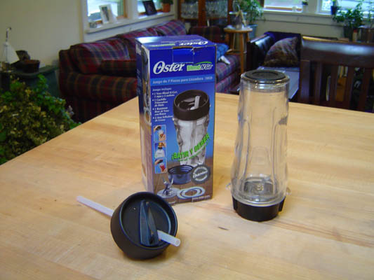

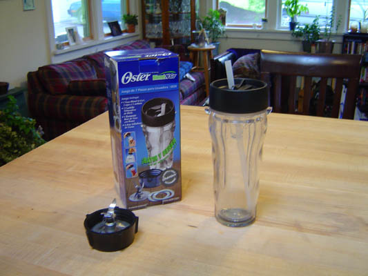

Found this at Wal-Mart (they were out of stock at K-Mart) in the blender isle. This is a Magic Bullet-type device designed for the blender you already have.
It comes with a cup, blades and gasket, and sippy cup lid and straw. These are all the replacement parts I would use with my blender anyways, plus the cup.
You put your ingredients in it, screw the blade base on, and put it on the blender
Here it is with the blades in it.
This still uses the 1/4 square drive, and thus works with my drill.

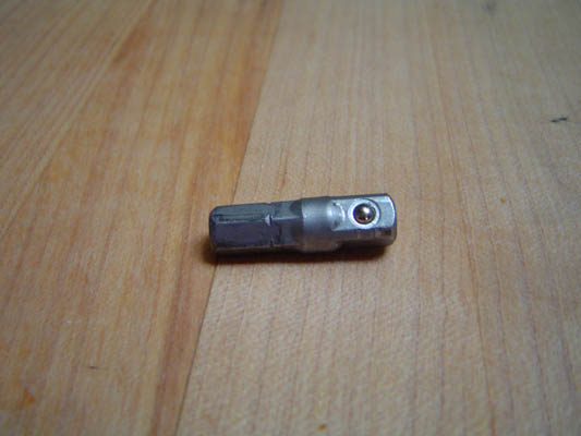

In case you were wondering, here is the bit I was using.
It is the standard drill 6-sided on the one end and 1/4inch square on the other. This was in my bit set for using 1/4" sockets on a drill.
I am sure a person could get one of these pretty cheap at the local hardware store.
