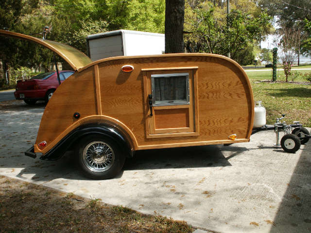

I do believe you just described my hatch, more or less. It doesn't leak either !! Sorry I don't have better pictures of the sealing surface but here is the hatch open picture. I think there are more pictures of it in the hall of fame photos. Good luck with the build, by the way, Chris is right, whatever plan you use, you can do it. Building a TD is just many small projects all tied together.

Steve_Cox wrote:Image
STEVE! I went to all that work to finish the side of your TD for you and went and stripped it all back off!! :o :lol: :lol:

Postby Steve_Cox » Tue May 16, 2006 10:53 am
Kerry,
Not to perpetuate your hi-jacking of the thread, I used this picture for Chris' benefit, something about the truck in the background upsets him. :lol: :lol:

Postby kayakrguy » Tue May 16, 2006 5:36 pm
Steve,
Yes, that is what I was thinking of doing. That is one beautiful
T! I am not sure why, but when you first posted this all I saw was a little square (no picture) and this time, bingo! good picture.
My thought is that having the hatch extend over the wall does not add much to the Bernouli effect but DOES create turbulence--which you addressed with the trim line extending around the cabin, matching that of the hatch.
Bingo! That is what my crazed mind was thinking about but had not connected to the idea of the trim line to lessen the turbulence.

Postby Steve_Cox » Tue May 16, 2006 6:55 pm
kayakrguy wrote:Steve,
I will continue to think and look. I would like to know how you did your weatherstripping etc.
Thank you again, Everyone! This is a fantastic board--great teaching and support....great place to kill bad ideas, too <G>
Jim
Jim,
I'll send you a PM later tonight with a photo of the weather stripping as you requested. So far I've driven in rain about 500 miles between 60 and 75 miles an hour and no leaks yet. But Paul was right a 2" overhang would cause some real stress at speed. My trim only has a 3/4" overhang. with a 3/4" radius on the corners, the water rolls off pretty well from what I could see.
