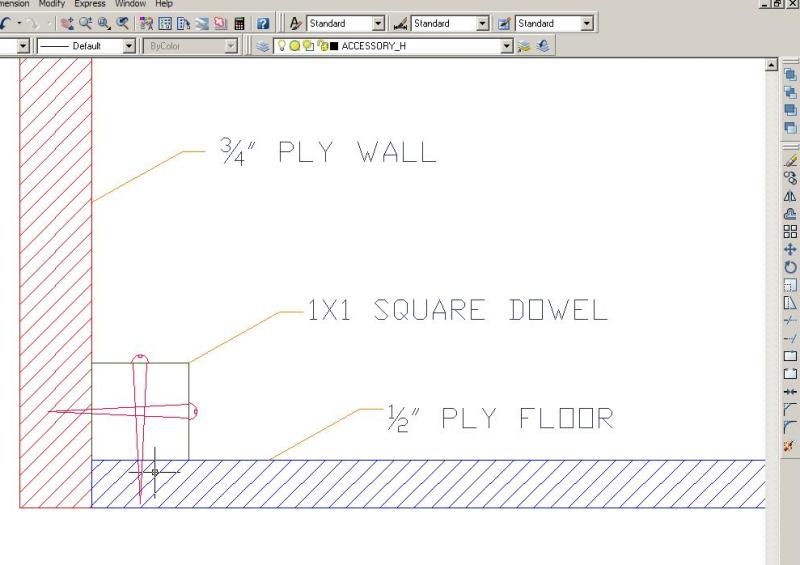

Postby TRAIL-OF-TEARS » Mon May 22, 2006 10:43 am
rampage wrote:The generic Benroy plans at the top of the page show you how most people do it.
I know Steve aka Trail of tears bolted 3/4 ply (i think) straight down to the frame. You might want to talk to him.
By the way good luck with the build and congrats on the win!!
Rampage, I actually used 1/2 ply. I built the body (floor walls roof) seperate from the trailer frame. I just slid the body onto the frame and bolted the floor down with 6 elevator bolts. This is a drawing of how I did it. The walls and floor are glued and screwed from the inside thru the 1x1 poplar dowel. I hope this helps.
Steve J.

Postby riverfront » Mon May 22, 2006 10:39 pm
I am overwelmed with all the support here!
THANKS ALL!!!!!!!!!!!!!!!!!!!!!!!!!!!!!!!!
EZ - Do you have pics or a drawing on how you layed out the floor - mabe a bottom shot before you turned it over?
Trail thank for the drawing!
