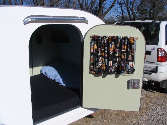

Postby rmcelroy » Sun Jun 04, 2006 9:36 am
Rainjer, the T you used looks like it has a ridge cut halfway down the leg. Could the leg be broken off at that point? Long story short I need a T with a 3/8 or 1/4 leg.
Mc
