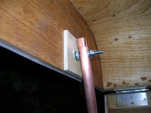

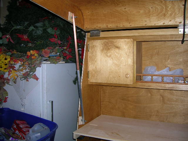

After long suffering and pondering, I came up with some non-gas struts for my rear hatch. I found some 3/4" aluminum tube (inside diameter) in the aluminum parts section at Lowe's. I then found that 1/2" copper pipe (outside diameter of .0625) fits nicely inside the aluminum tube. I then added some wood blocks and drilled thru the sides and used a carriage bolt, nuts and washers to make a stud to mount the tubes to. I still need to find a pin that will hold the tubes and hatch open. I capped the copper pipe for looks. It seems to work good so far. I will stain the blocks to match the wood and will cut the bolts down to the nylock nuts. I used ideas from others on this forum. Thanks! :thumbsup:
And I can still open the galley cabinet doors! That was a bit of a problem but it all worked out.

Does the copper tube slide easily inside the other metal tube, when you close the hatch? I've seen lots of people use a simple cotter pin to hold things in place, but that means you have one hand above you holding the hatch up and trying to put the pin in a little hole with the other hand.
I'm picturing some kind of "pin" or like a small bolt in place and it still lets the copper tubing slide out, then after the copper tube passes the correct point, the tension from the pin or bolt like thing would -snap- thru to make a stop for the tubing, therefore keeping it "up" ....
Guys, do you see what I'm talking about? I'll do some thinking , I would like to have non gas struts too, less maintenance. The only other idea I've pondered is something just like yours, bolted at the counter level, but not attached at the top. Then bring it down at 90* to lay across the counter while galley closed. When you open the hatch, then swing up the pole , and could have that block with the bolt extending out to slide it onto , then it will stay there, while you put on a wing nut or something.

The hinges work great as there is not a lot of weight in the rear hatch. I will cover the gap with a piece of rubber wide enough to cover the gap, hinge knuckle and use some aluminum strips to seal and hold it on. I will also use some gasket underneath. Can't be too careful when it comes to water.
And the pins will be something simple and easy to install and remove by one person. I can hold the hatch up and put one side in and then install the other pin with little effort. This also helps hold the hatch in place if there ever is a good wind. It won't fly up and drop on me! That could hurt. I thing Madjack had this same idea. I didn't come up with it on my own. Lots of reading here and experimenting. This IS a great bunch here.

Looking good :thumbsup: The combination of you came up with looks like a perfect fit. Now all you need are a couple of Lynch Pins. The pin goes through the tube and the wire bail goes over the end of the pin keeping it in.
