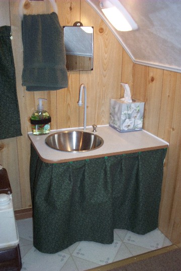

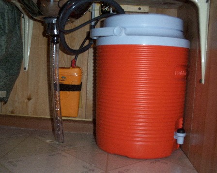

I used a battery powered pump that I purchased off Ebay. I just cut the hose off as required and connected it to a faucet that I fabricated from a plastic plumbing fixture. It has a battery box that holds 4 D-calls and also a cigarette lighter adapter so it can be run off of either. The picture only really shows the battery box as the pump is submersible. The unit can be seen as posted by Fornesto at:
http://www.tnttt.com/viewtopic.php?t=7513&postdays=0&postorder=asc&start=15
It pumps well with plenty (too much) pressure. I just pinched off part of the hose to regulate. Works well for me (not much use yet) and for $20 I have dual-powered running water.

Ira, if you look at my pic you will see a pull-on switch (bilge pump switch?) from the boating supply place to turn on the water. Of course that required a hole and you don't want a hole. Hmmmmm.

EZ wrote:Ira, if you look at my pic you will see a pull-on switch (bilge pump switch?) from the boating supply place to turn on the water. Of course that required a hole and you don't want a hole. Hmmmmm.
Ed
Oh--now I got you. I didn't look closely before--it's a facuet without a handle.
