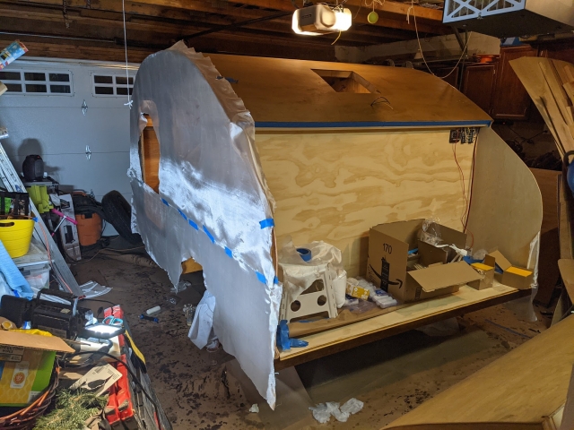

I ended up using 50 inch wide and just lapping it an inch or so on the sides of each plywood joint. Since the plywood was 48 inch wide, it worked well and I'm planning some sort of trim to cover all the joints anyway
Image 6x10 family teardrop, build thread: http://www.tnttt.com/viewtopic.php?f=50&t=73426
