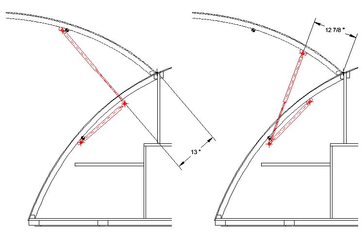

Andrew,
What do you think if you reversed it and had the strut (gas spring)13" out on the hatch and 30" out on the side? It looks like you would have a better mechanical advantage since the strut would be at about a 90 degree angle to the hatch when open. Would you need to change the strength of the struts?
I did not weigh my hatch before mounting, but I have weighed it at the back edge by proping it up on a scale and accounting for the weight of the prop. If the hinged weight is 30# then can I assume that the total weight is about 60#?
I figured that with a hinged weight of 30# and my hatch is 60" long and my strut is mounted 12" from the hinge then the weight on the struts would be 5 times the 30# = 150# /2 = 75# struts. Do you think that I should go with 110#, 120# or 150# struts (gas springs)? I don't want something that is going to sink because it is "just enough" nor do I want to have to pull too hard putting alot of strain on the hatch, strut mounts, and hinge.
Gerdo
Posts: 1361
Images: 156
Location: Littleton, Colorado
Postby angib » Mon Oct 03, 2005 3:50 pm
Gerdo,
1) Swapping the way the gas springs are mounted would make very little difference to how strong they need to be. Here is the example above with the springs mounted both ways:
How effective the gas spring is in holding the hatch open depends on how far out from the hinge it works. This is measured at right angles to the line of the spring. You can see in the two cases above, the difference is negligible. I've checked all the intermediate positions and there's no difference there either.
That wouldn't necessarily be true for a different hatch design, but I don't think the difference would ever become huge.
What is different is that now, in the right example, there's three-quarters of the hatch hanging out past the gas spring, compared to only half the hatch in the left example. So the bending in the hatch ribs is more than doubled - though whether that's significant depends on how strong they are!
2) Your hatch weighing method sounds fine to me, as long as it was perfectly level when you weighed it, and the prop was right at the end of the hatch.
3) As I understand it, your biggest loading is a hatch weight of 60lb and a distance to the hatch's centre of gravity of 30", so that's a 1800lb-in closing moment.
Divide that by 12" for the lever of each spring, and by 2 for two springs, and you get 75lb force on each spring.
110lb springs would give a 50% margin on that. Roughly (because I don't know your hatch's geometry) you would have to pull down with a force of 14lb on the end of the hatch to close it. With 120lb springs that force goes up to 18lb and with 150lb springs it goes up to 30lb.
So even with 150lb springs, double the 'hopefully just enough' level, you're not going to be hanging two of you off the end of the hatch to close it!
Andrew 8)

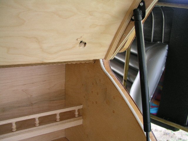

Postby mikeschn » Mon Oct 03, 2005 4:17 pm
I'll have to get you a photo of how my gas struts ended up. I tried it the opposite way, like angib showed in the first picture up there. I ended up breaking the end of the strut off, and putting a huge hole in the inside hatch skin, plus putting all kinds of ungodly holes in the side wall.
I'll be right back with a photo...
edit: okay, I'm back... here's the picture of how I messed up the gas shock mounting... :?
Postby angib » Mon Oct 03, 2005 5:55 pm
mikeschn wrote:I ended up breaking the end of the strut off
The only way to do that, that I can easily see, is to have mounted the spring so that it bottomed out before the hatch was fully shut.
If that is the case, which way up it was mounted is definitely a secondary issue!
Andrew
